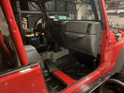

Yeah, ended up having a few honey dos to do sunday while no we dont have Ava but I did get to start the jeep. It Runs! and I used the FSM from 1997 and 2004 to see which color wires to use in the big loom that leads to the back of the jeep. On my 1997 TJ the rear wire loom has 8 wires with a plug where it meets the main harness, but on the 04 it has 22 and just splices into part of the under dash harness.

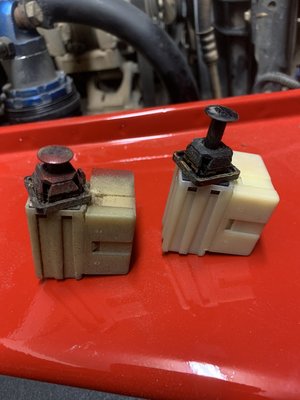

Chased my tail for a few hours looking for a missing ground, come to find out it was a failed brake light switch from the tub swap. I was able to swap the one from the LJ tub in and it worked fine.
