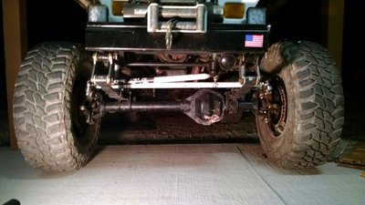

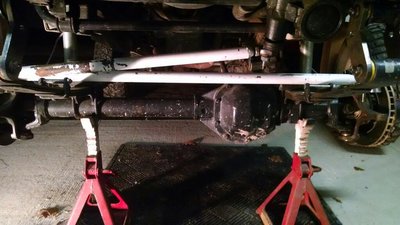

Ok, so I'm definitely doing a flat top knuckle and high steer arm on my passenger side for the drag link... But I can't decide whether or not to go ahead and do the driver side and get the tie rod up at the same time?
Went ahead and did both knuckles. I bought the arms and a 1" spacer but it wasn't in the box. So, It's mocked up right now with just the 1" arm and no spacer. Big improvement on drag link though even without the spacer.
Before and after

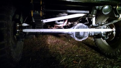

Works great..... Well a lot better
