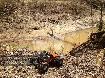

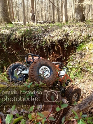

Well I was visiting in greenwood and had alittle spare time today so I drove around some back country roads trying to find a place to mess with the wraith. Ran it for awhile on a 2s battery and the motor got warm but never got noticeably hot and I can say I'm very happy with the way it all works together! Ill see once I wheel it on 3s one more time if im going to need yo change pinion/spur. Here's a coupe pics from 2 spots I found. One was just a big rock on the side of the road which I actually spent an hour at. image-54.jpg image-55.jpg image-52.jpg image-51.jpg

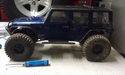

I changed out my steering rod ends and lower link rod ends with Traxxas ones. This stretched it a little, so had to put a spacer in the upper 3 link and had to clearance the front bumper to clear the servo horn.
Wheelbase is 12 5/8 inches now...
