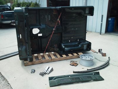

So.. I came across a steal on a marginal TJ tub that I couldn't resist. $100 for the tub and it had a few rust spots in floor boards and a small spot on the passenger side. Originally was only supposed to get the tub but the guy went ahead and gave me a good windshield frame (broken glass) and the TJ cowl piece. Its got a few dings in it here and there, but overall pretty good shape.
Had lots of old CJ spring plates, a set of CJ front leaf springs, TJ tailgate, wheels, tires, etc.. a fair amount of all the parts needed already.
So, follow along.. as we go to hopefully build at least something interesting...

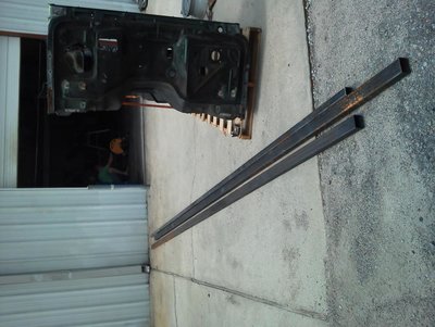

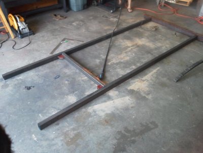

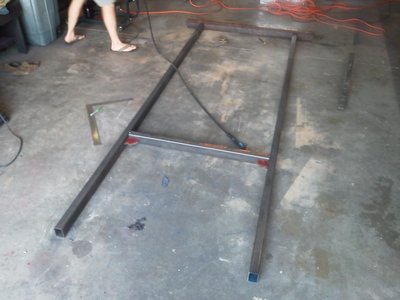

IMG_20110827_151122.jpgIMG_20110827_151133.jpgbought some 2 x 3 tubing for the basic frame, 2" square tubing for the tongue and a 2" x 4" tubing piece for the rear bumper.

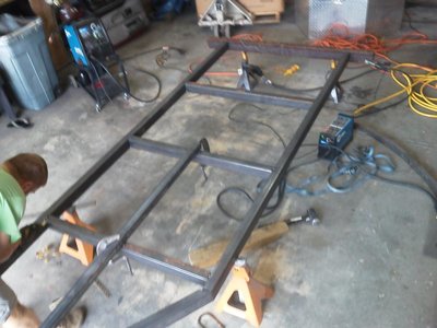

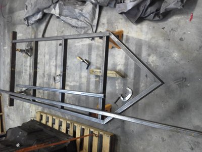

Getting basic layout and tacking everything together..

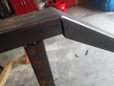

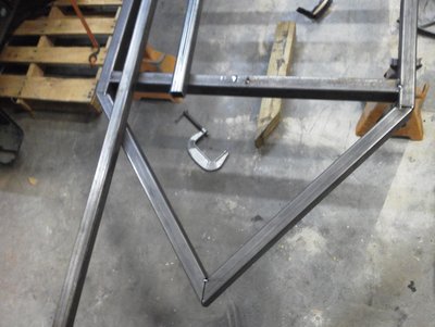

Plasma cutter makes things nice and quick.. !!!! cutting a notch to bend in the front 2 tongue pieces to the center...
