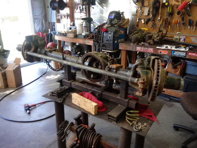

So i went over the location and made a deal for $325 for the axles. The front axle was already setup for high steer with flattop knuckle and upgraded linkage. It was still connected to a Saginaw box, so i have an extra one now. When i got home i pulled the front axle cover and water poured out
. BUT everything was relatively clean and the water might have been from the rain just a few nights ago. AND in my face was a Detroit Locker
The gears were 5.38 with a touch of rust, but the gears were in good shape. Even had WARN locking hubs and the axle was not a vacuum version.

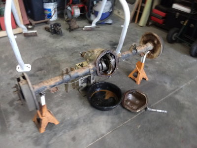

Next i go to the rear axle. The seller mentioned that it was locked. I assumed it was welded because it was in a mud truck. I got the cover off and it had a Trutrack and 5.38 gears.
It was a very good score, not drop in at all, but enough there that i did not lose any money. The YJ is going to get some jewelry.
