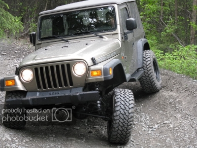

I bought my 04 TJ on a Friday in April of 06 was not planing on doing anything to wild and crazy just a weekend rig and a DD... So the next day I order a 4" Rough Country Lift with a set of 33" Procomp M/T's rapped around a set of pie cutters... Nov of 07 I joined the Army and was stationed in Alaska.. There are no small Rigs up here I guess thats when the JEEP BUG bit... Right after getting up here I picked up a set of PSC flat fenders for cheap... Then I found a set of 36" TSL that had never been on the road just trailed for cheap as well and added a 2" bugget boost... Then I picked up a Smitty built SRC front bumper off Craigslist, and then I deployed... When I got backed I orderd a set of Genright Highrise 3" flares and a rear SRC to match the front and a Smittybilt XRC 8K whinch... Some where along the way I upgraded to a set of 38.5 TSL's didn't like them so I went and bought the tires I am running now 39.5 IROCK'S... It curently has a basterd lift of 8" 4"short are 2" booster and 2" body not ideal but it works for now... I am curently in process of moving back to the Lexington area I was injured in Afganistan, Army has kicked me out... So I am going to take a brake for a little while to build my Jeep like it should be... Plans are LS1/TH400/ATLASII HPD44/D60 3link/4link 250/250/250/300coilovers... I have the Axles now just waiting to get the engine and trans when I get down south limited space on the move... Any imput on the build would be helpful this will be my first big build...

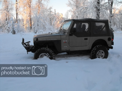

pics2046.jpgThis is out by the Knik River ...

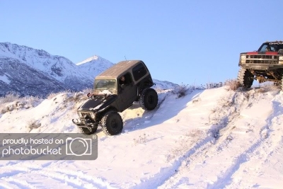

This one is here on Fort Richardson...

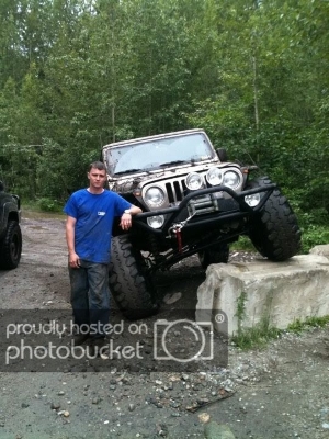

This one is on the Buffalo mine Trail...
