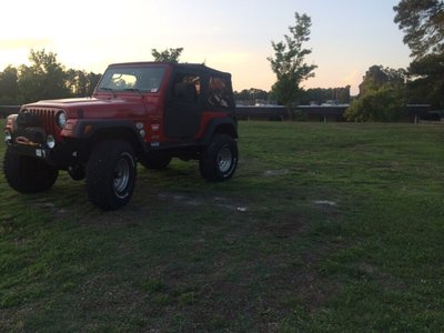

It would. I tested it with my jeep tonight and just unlocked the front hubs for the rear locked front open test. It was about 5' smaller radius with the front locked.
