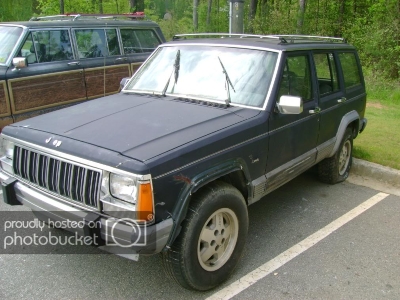

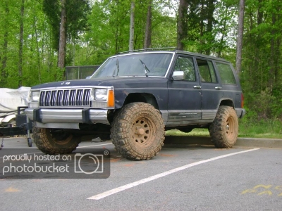

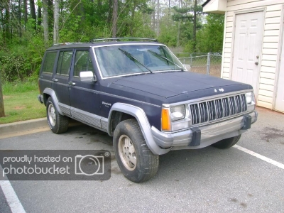

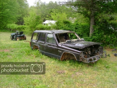

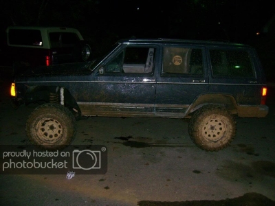

before:

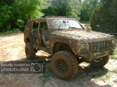

after:
well last night we got her running and drove her around. Thanks to brent for coming out and helping with the fuel pump. The fuel tank is rusted out, so we are going to have to put another tank in it. We also need to blead the cooling system as we are having some overheating problems.
but its alive.

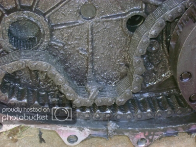

also, the tcase grinds in 4 low, but we arent sure why. i need to put a front ds on it and figure out whats wrong in the tcase.
Anyone have any 242 tcases for parts? or an old 231 they dont need. or just a 23 spline input on a 231.
This is what everyone was waiting for!

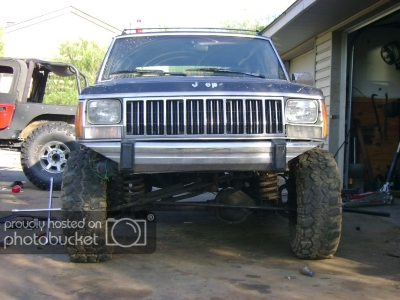

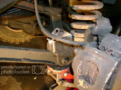

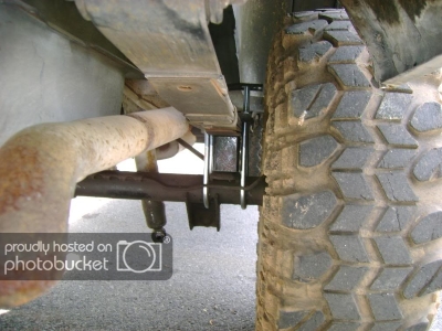

You get to see the lift, and the amazing goo that helped keep our little t case lubricated.

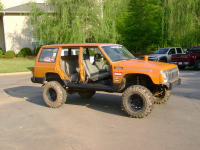

we havent cut the front bumper yet and we havent done the killer rattle can paint job, but it still looks cool.

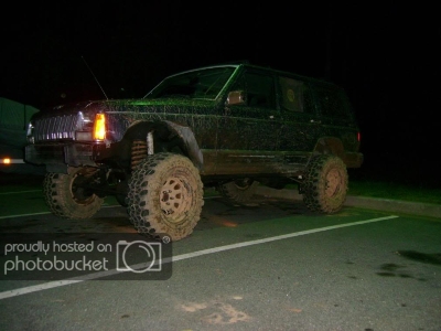

already at trail pressure, well at least one on them is

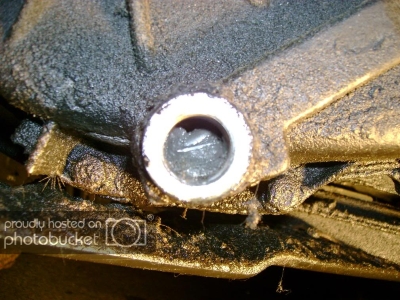

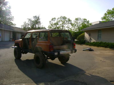

First is the 242 t case that came out, it looks brand new (NOT)

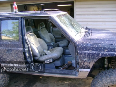

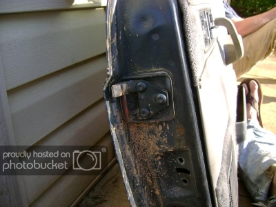

Second is the removable doors bc every Jeep should have removable doors
Third the bumper cut, a little better not sure if its final though

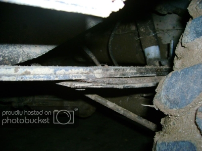

got the extra leafs in the pack and it doenst bottom out nearly as bad now when it catches air. We still have a ds issue. our tcase is out of a yj so it is a UJoint front ouput not a CV and we have a CV XJ front shaft. So we are in need of a CV output for a 231 or a YJ front driveshaft. We are going to try to drill out our front yoke to allow us to put the CV ds bolts through, but im not sure if the head of the bolts will fit back there.

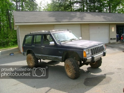

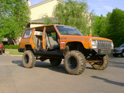

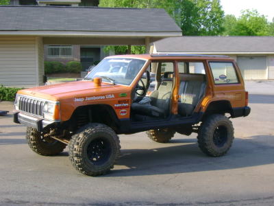

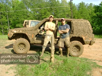

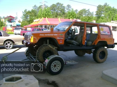

We are painting her tommorrow. Andrew took some updated pics tonight of the jeep, dunno when he might get them up.

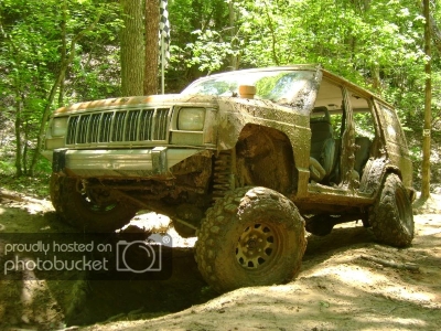

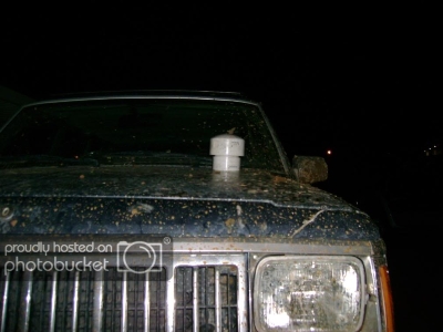

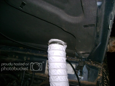

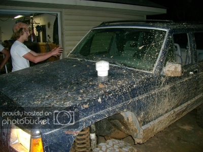

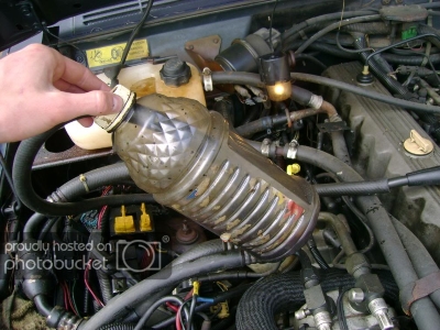

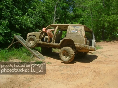

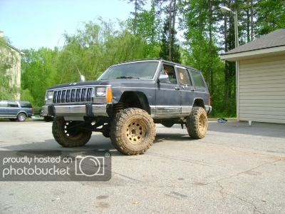

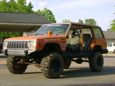

here it is the long awaited snorkle, Im sure its not what most of you pictured but it is simple and functional.
Casey what were you doin in this pic.
Look how meaty those swampers are
found some pics from our paint session
