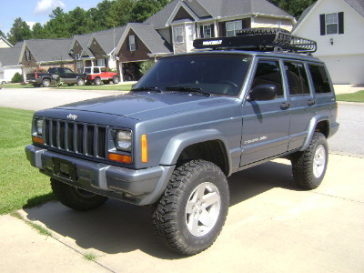

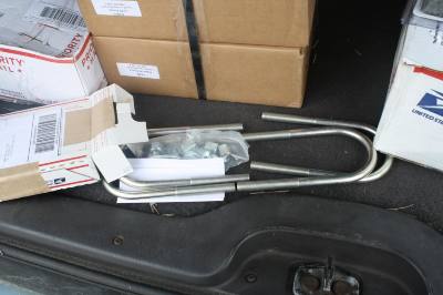

Well the time has come for me to introduce myself and my project .It is a 99 xj classic .The purpose behind this build is kind of personal to me. I work for a company that serves the military and I work with current and former military on a daily basis. I feel a kinship with them and have the utmost respect and appreciation for what they do for our country and our freedom. So to do my part in giving back to those how have given us security at the home front at the cost of an injury (physical or mental) I present project warrior.DSC04170_zps89fa35b7.jpg

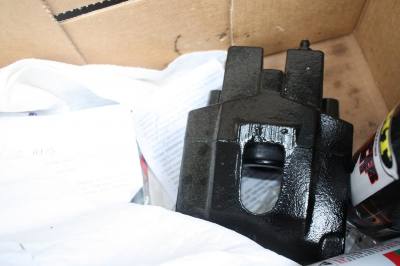

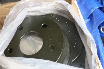

All new ft calipers, rotors vented and slotted, and pads

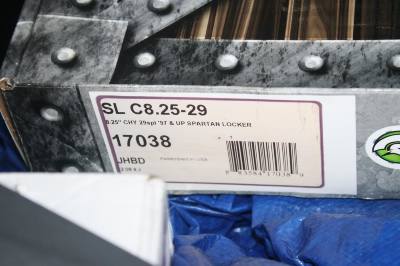

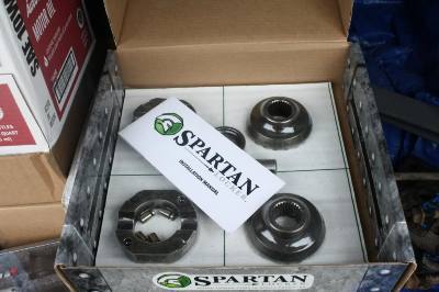

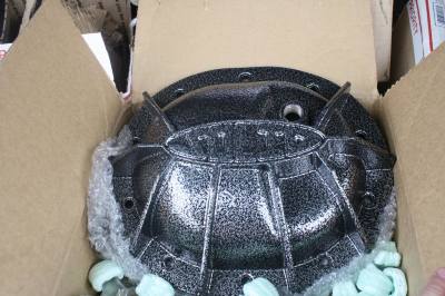

Chrysler 8.25 rear axle swap with disc brakes and locker

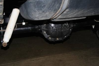

The reason I am doing this build is to attempt to get with my local VA or the wounded warrior project and take 3 wounded military persons on an all expenses paid weekend wheeling and camping trip up to 4 times a year. To help them get their mind off of the obstacles they face and bring a sense of peace to their being if only for a short time. I currently do not have any vendor sponsors but do have a few local sponsors one of which is supplying a Chrysler 8.25 29spine axel and the rear disc conversion from a zj in exchange for my d35 that is currently under the jeep. I am doing this all on my own dime. This project will take some time to get finished but I hopefully will be able to achieve my goal. Any input, opinions are more than welcome and if any vendors on here wish to contact me please pm me Thanks in advance for your views and comments...

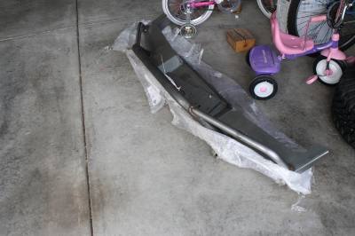

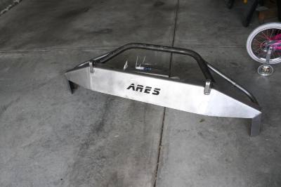

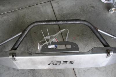

Got off the phone earlier with James at Ares Fabrication (http://aresfabrication.com/) He is a really stand up guy and has some awesome products. I particularly like the evo winch bumper and I think his tire carrier rear bumper is priced reasonably and is full of options and looks good. After a good conversation he has decided to come on board and help the cause Thanks again James!!! Can't wait till brown Santa comes.Let's just say most of my armor is taken care of at a great price.
