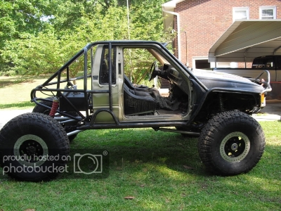

A few months back I parted out my old cab truck. I'm a toy man at heart, I liked the one tons but never like I loved my old toy axles. I kinda miss the 4 link and coil overs but my whole plan for the build was to get back to the basics of what worked for me. I gotta say it was a sad day to see it go. R.I.P

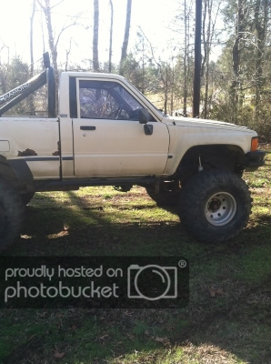

Back in 94 my best friend scooped up an 85 bone stock cherry Toyota. Through out high school we tinkered with it. We did the standard Smittybuilt double tube bumpers, and roll/light bar. Put a Warn 8k winch on, Trailmaster 2" body lift, 4" Skyjacker lift, Downey shackles, aluminum wheels, and 33" THORNBIRDS! Remember they had just come out and no one knew how bad that tire was yet.
We were the usual broke kids so we drove this thing everywhere. And let me tell you young bucks something. It's along ride in a single cab yota, loaded down with camping gear and everything thing else. Then a 4cyl on 33's with 4.11 gears through the mountains to Tellico. But we did it and was smiling the whole way. We even drove it to Chatanooga in 97 for a big ride. I'll tell ya something else, THORNBIRDS will get loud enough on the interstate to drown out a Toyota radio.
Eventually we put a lock right and some 5.29's in it and welded the rear. Marlin Crawler was just starting up so case gears where not an option yet and the Internet was just starting up so you can say us right coasters were a little behind what the left coasters were doing. The truck sat for 4 or 5 years at his moms and never moved. Once I got my 85 we dug his out. By then Trail Gear had come out so he ordered some 4.7 case gears and we put some 36" iroks on it. It went to River Rock once and maybe twice to Tellico before he parked it again. It took me a few years to get it but he has a family now and both of us hated to see it just rust to its death. I started stripping it down the day I got it to try and maken Oscar. I had a basement full of parts for another build already.

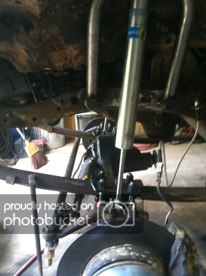

I completely stripped down the front end. I cleaned and rebuilt the knuckles, installed Longfields and drive flanges. Ifs hubs and rotors and Arp studs. I went low steer this time around after much debate and talking with PSC about the length of aftermarket high steer arms and the added leverage they add. Put a single ended ram on with full hydro. 3/4 ruff stuff hiems and .250 wall Dom tie rod and a Sky manufacturing diff covers and low profile front spring hanger.
With the new spring hanger and running rear springs up front it pushed my front out about 2.5". Whiched worked out well to get the tires away from the cab.
Got the Psc pump and reservoir/ filter mounted up. Steering is very nice now.

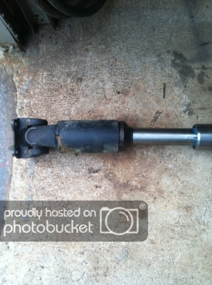

Built a front driveshaft using the Trail Gear long spline kit. That thing is a beast, I think I remember seeing one of those on a skidder some where.
Not really a good pic at all. I built a rear shaft also, I cut the factory ends off and welded them to a piece of 2.5" sch40 pipe.

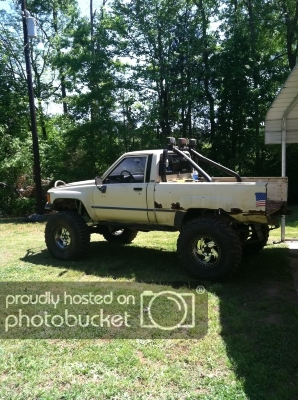

This is the best I could get it befor the weekend trip to Harlan. I'm gonna swap out some half doors we built, do a little fender trimming and load up.
Gone try and clean up the rear before I load up to leave wensday. I ordered 12" Bilstiens all the around, not even thinking they wouldn't fit.
