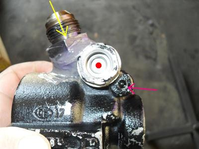

In all of these photos, yellow indicates low pressure intake flow from reservoir to pump. Red indicates high pressure flow. Pink indicates valving pilot flow. To learn more about valving see the above linked thread.

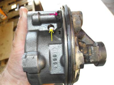

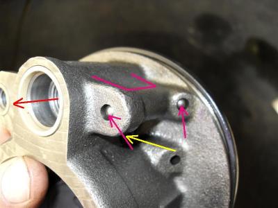

In the above photo fluid begins entering the pump through the large intake port at the yellow arrow. It ends its journey through the pump through the output orifice indicated by the red arrow. A pressure compensated flow control valve is operated via porting that is machined into the case of the pump. You can see where the port is drilled and then capped during manufacture from the side of the pump indicated by the pink arrow. The pilot flow path is indicated in pink going from the output fitting to the flow valve behind it. The following photo shows the view from the front of the pump where a second hole is bored to route the pilot fluid back in toward the flow valve. You can also see the front shaft bearing which is one of the two bearings that make TC pumps unique. All of the other pumps discussed in this thread are only supported by lubricated bronze bushings. Being that the TC pump shaft is supported front and rear by roller bearings it is generally believed that it can handle higher rpm’s than the others. I have evidence to both confirm and dispute this which I will discuss later.

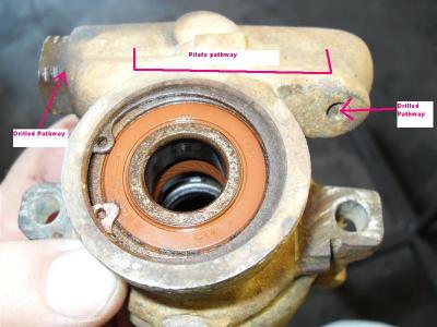

Looking at the bare case from inside you can see the other end of the external ports. The pink dot indicates the difficult-to-see port where pressurized fluid is bypassed back into the low pressure side of the pump by the flow valve to relieve system pressure. It is this pressure compensated flow relief that prevents hoses from blowing out during pressure spikes, similar to what occur when we nail our tires against immovable objects at full throttle.

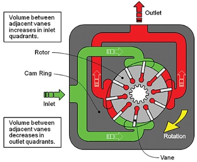

The following is a diagram that Ls1toyota provided for our reference. It explains the basic workings of a vane pump which you can refer back to as I continue:

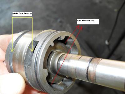

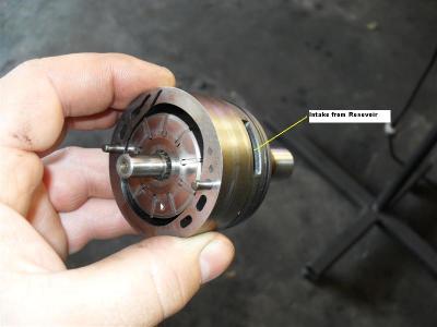

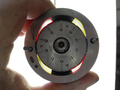

Here you can see the TC Pump’s cam pack removed. From left to right you see the back plate, the cam ring, the front plate, and the shaft. Fluid comes in the intake orifice and fills the body of the pump where it is then sucked into the inlet ports shown here. The o-ring you see seals inside a machined bevel in the pump body thereby sealing the low pressure zone (back of the pump housing) from the high pressure zone in the front.

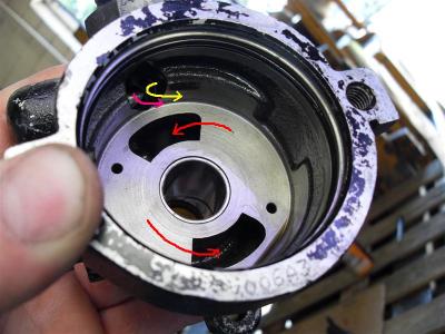

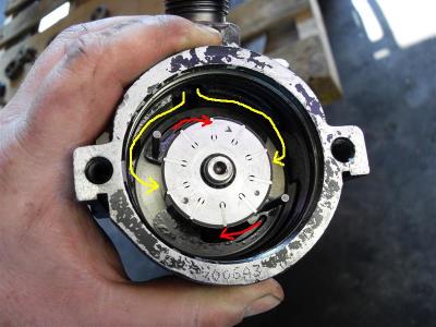

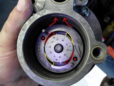

Stripping away the internals one by one, this is a pic without the back plate on. Again, you can see an intake port only this time the vane rotor and cam ring are exposed. The vane rotor is splined to the pump shaft and rotates via the belt and pulley on the front of the pump. The vane rotor is the one and only internal component of the pump that spins. As it does so centripetal force causes the vanes to slide out of their grooves and come into contact with the inside of the cam ring. This is not the only force that causes them to do so though. As they create pressure fluid is forced through the oblong passages seen on the face of the cam ring from the front of the pump all the way to the back plate where it is then routed back down to the small holes you see at the back of the slots that the vanes are in. This not only helps to lubricate the vanes but also forces the vane outwards to keep them from being forced back in by the pressurize fluid that they are moving.

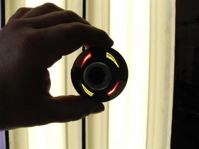

This is a photo of the back of the cam assembly without the back plate on it. Held up to the light you can see how the vanes follow the contour of the cam ring, forcing pressurized fluid out of the ports toward the front of the pump. The following photo is just a picture of the same component from the opposite side.

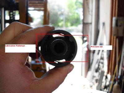

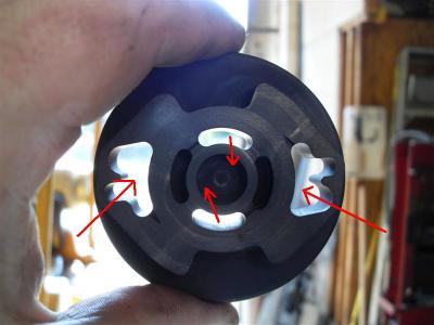

Another pic of the whole assembly from the front side, showing where the pressurized fluid exits toward the front:

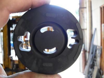

Below is a photo of the front of the back plate. You can see the high pressure lubrication pathways and also the intake ports. The back plate seals against an o-ring in the back of the pump housing and fluid pressure at the front of the pump forces the entire cam assembly back against this back plate which then is stopped by the large c-ring that rests in the groove of the housing. Again, you can see the roller bearing that makes the TC unique. The TC is also unique in that it is the only pump that uses the back plate as the actual exterior of the pump also. This means that instead of all the pump’s pressure coming to rest against a thin piece of stamped steel, like all the other pumps, it comes to rest at a sturdy, thick piece of cast steel. This may mean that the TC has the ability to build more pressure than the other pumps but the casting is very thin in the middle. I accidentally shattered my back plate there while working on it. This may negate what would seemingly be a very sturdy barrier. I don’t know …

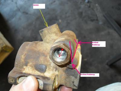

Fluid goes in the intake. Please excuse my ghetto-fabulous –AN fitting that I rigged up. It’s not pretty but it works. Fluid exits the output orifice and you can see the pilot pathway as well as where the pilot pathway is machined and then capped during manufacture.

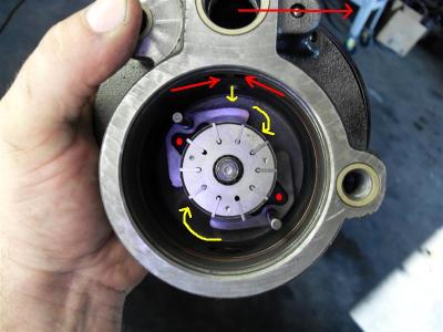

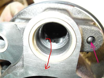

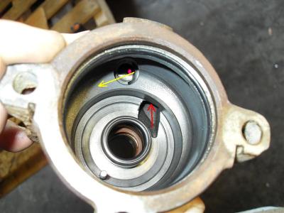

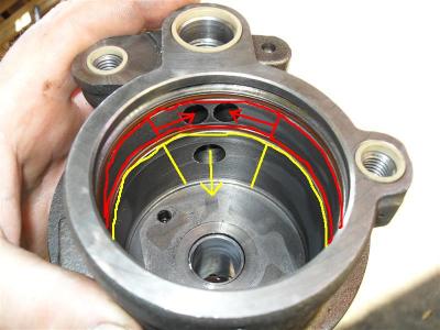

Looking into the inside of the empty cast housing you see where intake fluid comes in as well as pilot fluid during pressure relief. The CB is unique in that it has the pressure chamber separated from the rest of the pump via a cast wall. This means that, while the TC used fluid pressure to force the cam assembly BACK toward the back plate, the CB diverts pressure from the front of the pump to the back between the rear bulkhead and the back plate to force the cam assembly FORWARDS. The reason this is important will become clearer soon.
Instead of DISASSEMBLING the CB part by part like we did the TC we are going to ASSEBMLE it part by part for explanation this time. Below you can see how the front plate holds the vane rotor up off the dividing wall and takes fluid into the assembly through the voids created by the shape of the the plate. Pressurized fluid will then exit through the holes in red. Pressurized fluid is not allowed out of the front cavity backwards past the front plate because there is also hydraulic pressure forcing the front plate down against the machined flat surface of the pump body. More on this to come …

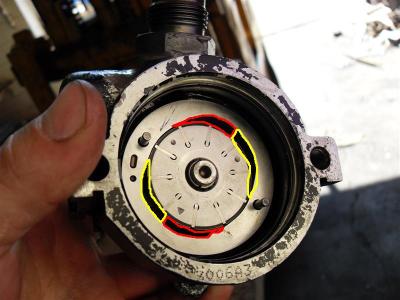

Inserting the cam ring makes the pumping cavities apparent and the low pressure vs. high pressure zones are highlighted. Try to imagine the void in the shape of the front plate above that is no longer visible and how it feeds into the yellow section in the pic below.

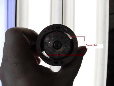

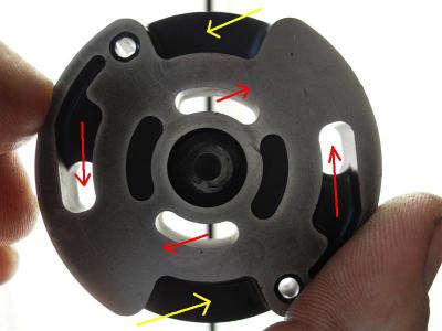

Following are just some other pics of the cam ring with rotor and vanes. You can see the holes at the base of the vanes that fill with pressurized fluid to keep them pushing outwards.
Below is a photo of the front side of the rear bulkhead. A small amount of high pressure fluid is bled off the vanes up through the outside holes shown. On the back side of the bulkhead there are pathways that route it back in and down to the center of the cam ring to lube and help actuate the vanes. (See second pic.) The back plate of the pump housing is not pictured but it is shown later in some comparison pics. As high pressure fluid leaves out the back of the outer holes it also pushes against this back plate, forcing the entire cam assembly forward against the front of the pump body and creating the seal that was previously discussed.

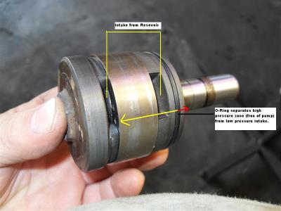

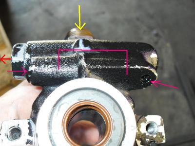

Starting with the outside of the P-Pump’s cast body you see the red pressure outlet and the yellow fluid inlet. The P-Pump has an inlet on both sides that tee into a single pathway internally. You can also see the pilot fluid pathway and how it was drilled and capped during manufacture. Below are just some other angles of the same. You can see through one inlet out the other inlet on the opposite side in one of the pics.

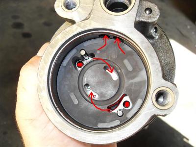

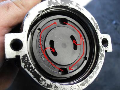

Looking into the bare housing you can see how the two inlets tee into one single port inside the pump. High pressure fluid exits through the two ports closest to the camera. The P-Pump high and low pressure zones are split by two o-rings. I have colored the two zones accordingly. The P is opposite the previous two pumps discussed in that their high pressure zones are in the front of the pump whereas the P’s is in the back. No matter …

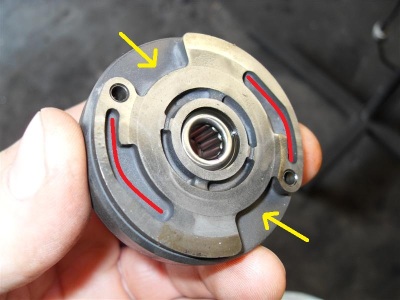

Above the vane rotor and front plate are installed. Like the CB, fluid enters the vanes via the openings left by the shape of the front plate. The high pressure fluid is pumped backwards up through ports created by the depression cast into the front plate where you see the red dots. With the cam ring installed in the next pic you can now see how this is accomplished. If you view the red dots as arrows pointing directly at you it makes more sense.
As high pressure fluid is pumped back toward the rear bulkhead of the pump it exits the rear of the back plate and fills the high pressure zone interior of the body. Most exits the pump at that point but some is forced back down the holes in the center of the back plate into the center of the vane rotor where it lubes and forces the vanes outwards just like in all the other pumps. Below are some other shots of the back plate and how fluid flows through it. The first one is the view from the front side of the back plate and the second is the back side.

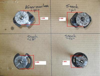

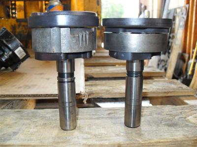

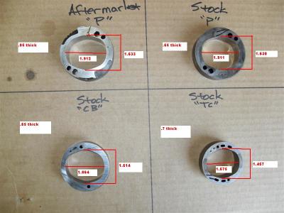

Comparison of all the pumps’ cam rings:
I realize the writing is somewhat small but if I posted a huge pic everyone would complain about the size of the pic. I was extremely surprised by what I found in this comparison though. The internal size of the cam ring from the aftermarket P, OEM P, and OEM CB is virtually IDENTICAL. What’s more, the thickness of the OEM P and CB are also identical. This means that, assuming the vane rotors are the same size and there is the same number of vanes in each, they should have nearly identical outputs. (It comes as no surprise that the TC is smaller than the rest.) So what about the rotors and vanes?
Yup, all identical except the TC being the runt of the litter. Thus, OEM CB = OEM P in terms of output capacity. Let’s compare the back plates and rear bulkheads of all the pumps:

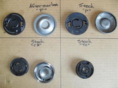

This comparison is important because most of the time when upping pump pressure the rear bulkhead, whether that be the back plate (as in the case of the TC) or just a tin cover (as in all the other cases), is what blows out when there is too much. Notice how the aftermarket P is convex and the OEM P is concave? There is a reason for this. The aftermarket P’s cam pack assembly is .2” thicker than the OEM P. The net result of this is that the aftermarket P has ~30% greater capacity than the OEM P! The back plate is convex to make room for the thicker cam pack. “So obviously, it’s better to buy aftermarket for increased capacity, right?” Not necessarily. The thicker cam pack in the aftermarket pump, as discussed in this thread (http://www.pirate4x4.com/forum/showthread.php?t=708701&highlight=convex+pump), was just a different internal design used by Sagninaw and until recently was readily available. While all of my stock P-Pumps had the concave back plate, all of my aftermarket pumps had the convex one with the thicker cam packs. I verified this by taking apart yet another aftermarket pump (no pics) and confirming. And while both aftermarket pumps were from different companies, the cam rings and vane rotors both had the same exact castings and machine marks. Other than these differences, the aftermarket and OEM P-Pumps that I have all appeared to be identical. And while it is possible that there are material differences that are not visible to the naked eye, to me it appears that the aftermarket pumps THAT I AM IN POSSESSION OF have nothing done internally that is different than stock other than having the larger internals that were originally offered by Saginaw. (Comparison pic below.)
There were no other differences that I could identify aftermarket vs. OEM. None of the internal passageways in the aftermarket pumps were larger or anything. Some of the aftermarket pumps did have the West Texas Mods performed on the valve bodies that are so popular, others didn’t. “So assuming we can’t get a hold of the larger internal versions of the P-Pump, we’re still better off buying aftermarket, right?” My answer is MAYBE and it is open to debate.
You see, to have 30% more OUTPUT, you have to have 30% more INPUT. Like I said, the passages leading into the pump were the same size between large internal and small internal P-Pumps. This MAY explain why the aftermarket pumps I’ve had in the past were so much more prone to cavitation, especially at higher RPMs. No matter what size supply line you have, there is still a bottle neck where the fluid enters the pump. And if you can’t supply the 30% higher input, you won’t get the 30% higher output. Most likely, all you will get is the dreaded CAVITATION.

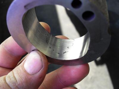

One of the best images I’ve seen is there and shows how cavitation can cause damage to the surfaces that it forms on:
Here is the cam ring from the pump on my last buggy that was wrecked. You can see the pitting caused by the cavitation. I have no doubt that this pump is toast:
