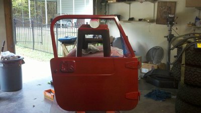

So I got a few prices for painting my hard doors and they were all upwards of $300...which I admit, If I wanted a perfect paint job I would gladly pay. But the rest of my jeep doesnt exactly scream "scratch free". So I decided to do it myself with some of the color match cans I had used in the past. The color code was PR4 for my jeep and i had seen in the past that the color match cans were pretty close to the actual color. I figured that a paint shop wouldn't be much closer.
Knowing what I know now I should have thrown down a coat of primer under the red, but from talking with some body guys they said it would adhere well to the existing paint. I used about 4 cans of red per door and then 3 cans of clear coat per door. I really used it thick on the outside in hopes of being able to polish it to a nice shine in about a week after it cures.
I sanded the doors down, alcoholed them down, sanded them again, taped them off, acoholed them, then sprayed down a tack coat. then I proceded to paint about 2 cans of red, then I wet sanded the doors, then I sprayed 2 more cans of red. Then I sprayed all the clear coats. I did wetsand one blemish in the clearcoat on one door then threw on the rest of the clear.

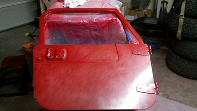

here are some pics, I'll put some more details in tomorrow.
Ans another

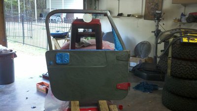

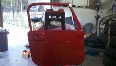

Couple more

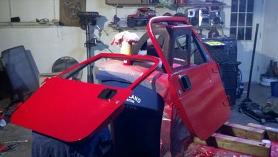

Wet sanded

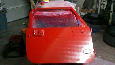

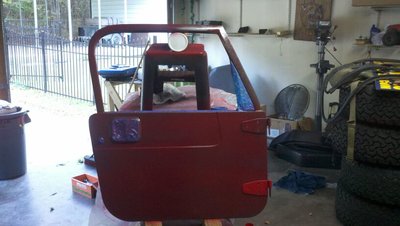

This series of photos took three days

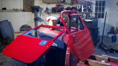

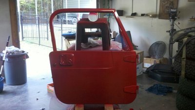

Now let them dry for a week before polishing them

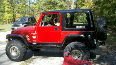

those came out pretty good. i had to use those color matched cans to fix a rocker on my f150. they work pretty well.
Thanks. I was adding up the cost and all together it cost me about $84 to paint both doors. It did take me 3 days of sanding, disassembling, tapings, more sanding, painting, more sanding, painting, clearcoating...now wait a week, and then polish.
But for the money spent, I hope it was worth it. I'll find out in a few years i guess.
