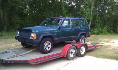

So, I finally own a Jeep. I picked up a '94 XJ 4-door Sport, cosmetically rough, but mechanically sound from my brother-in-law. He bought it from the original owner a few months ago and only drove it 170 miles. They're moving and can't take it with them.
I haven't really gotten to check it out yet. I'm just amazed it hasn't caught on fire from the original owners wiring and the AC controls under the dash are supposedly melted. That's the first project...
This will be more of a driver than a crawler. I've been wanting something that I can drive when I don't feel like trailering the Sami. It'll be a Bumpus, Clemson 4wheel poker run, and occasional 33/Gulches trip rig, and around town beater.
I'm planning on 4.5" lift and either 32x11.50 or 33x10.50, but it will all depend on what I can find used and cheap.
