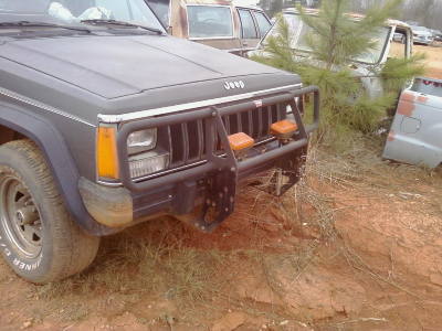

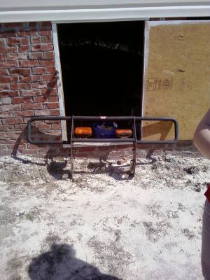

I bought a Warn Brush Guard for my 96 XJ the other day at a local junk yard. It was on a Comanche which I have a picture of. Removed my front bumper today to install the brush guard and and after putting the bolt down in the frame and bolting down the bracket I placed the brush guard up to the brackets to bolt it on and it doesn't fit. Warn's website say's there bumper is for 1984-1996 WAGONEER, CHEROKEE, COMANCHE which is what the Comanche and my Cherokee are. can't figure out why it won't fit? And help or pictures would be a great help Thanks
I found this on the web and this is what im supposed to do and this is what I did and it won't fit?

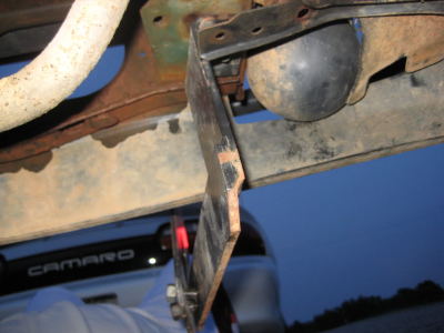

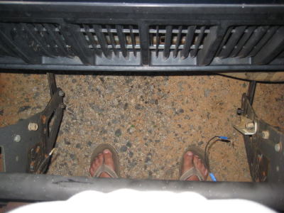

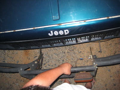

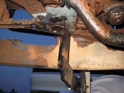

Here are some pictures of the brush guard on my jeep.
This overhead shot shows how the brackets are turned inward just to touch.
These next two shots show how far it is from reaching the other side. Both the brackets are straight in these pictures.

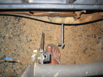

This is looking outward from the driver side bracket. Notice the gap in the bolt on the bottom of the brush guard thats how far inward it is angled to touch the other side.
This is looking outward from the passenger side bracket. Notice the gap in the bolt on the bottom of the brush guard thats how far inward it is angled to touch the other side.

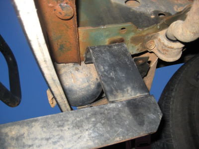

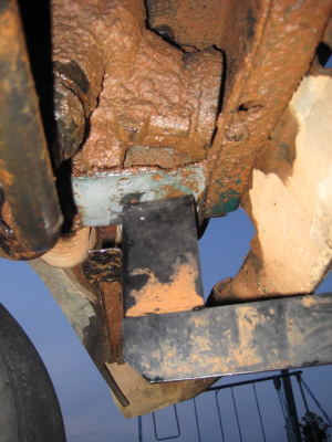

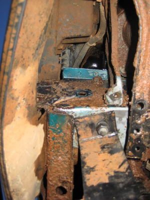

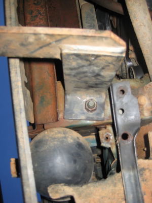

This is looking up at the frame rail on the driver side it is bolted into the only hole in the frame same as the diagram pictured above. Notice the small bracket the supports the fender just like the green peices on the diagram that I have to cut back some.
This is looking up at the frame rail on the Passenger side it is bolted into the only hole in the frame same as the diagram pictured above. Notice the small bracket the supports the fender just like the green peices on the diagram that I have to cut back some.

its hard to tell from the pictures but can you mount it in the other hole in the unibody toward the center of the jeep? which hole did it come out of in the cherokee?
