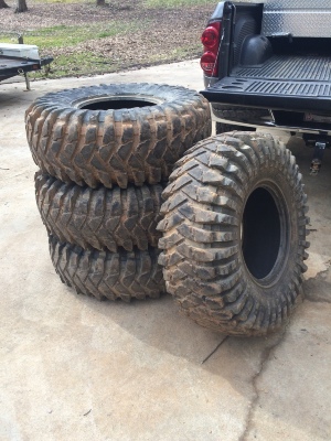

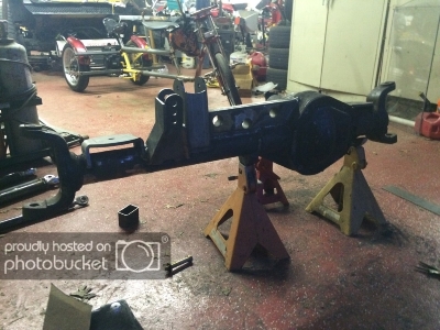

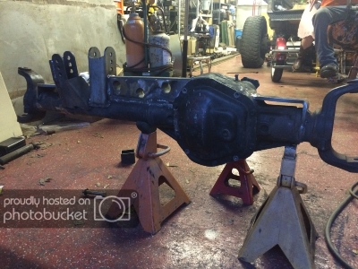

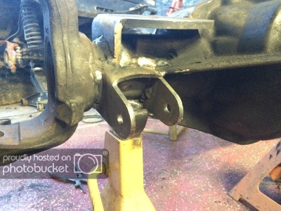

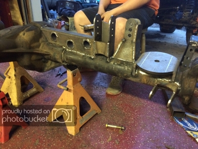

Calling it a night. Got a good bit done over all today. Got two of the 40s mounted up and on the rear axle to help me visualize ride height for the 3 link, Got the the coil buckets and lower mounts on the axle. For the driver side I tried to cut as little as possible out of the pumpkin. I did happen to grind a small hole in it though, no biggie though just welded it back up and forget about it. Got the frame brackets tacked in and PVC lowers mocked up. From the looks of it will work but still need to check tire clearance. The upper PVC mock link is just hanging there at that moment. Might get to tacking it in tomorrow and then the process of cutting out my floor to gain the separation I need between the lowers and upper. Other than that pretty success full night. Will try to get back to it tomorrow.
