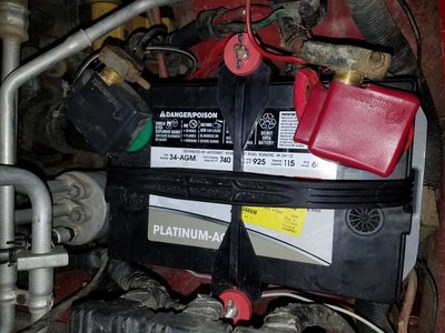

New battery in. Fired right up and purrs like a kitten. An old, asthmatic kitten, but purrs nonetheless.

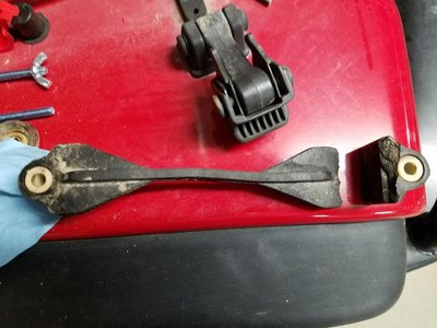

I remember asking about stock tj battery hold downs. Back in 2012/13, I couldn't find them, but they're available now. This is what the generic rubber one looks like now
20180423_210413.jpg.
Can't get the factory one before Wednesday, so another rubber one for now.
Shoot, maybe I will stick with what I have a while longer. It's a universal one from the parts store but is similar to the OEM.

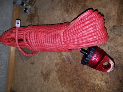

My old winch rope is going on the trailer. I got this rope a while back in a FB auction and finally picked up a thimble. Now I need to figure out why the brake doesn't work on the 9.5ti.

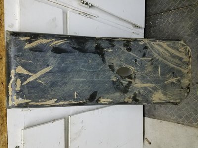

The UCF skids have been doing their job.

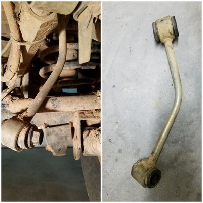

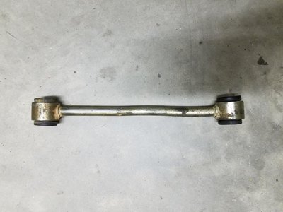

And the rear sway bar and link took a pretty hard hit at some point.
Harbor freight press to the rescue again.

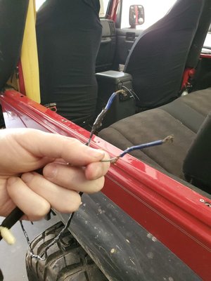

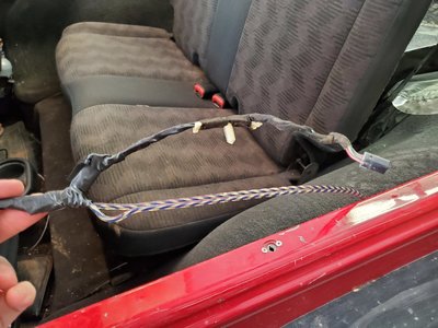

I uncovered some ghosts of past owners pulling the stock cage. Someone had tapped in a couple speaker wires from the pods, by twisting and taping the connection, then put a short piece of wire in place of the cut and just twisting that too.
WTF Jeep?!

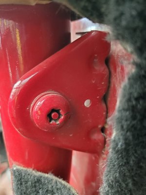

I twisted my security torx bit on this one. The other side came out with the twisted bit, but this one took vice grips.

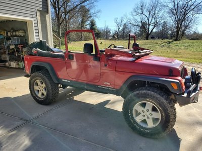

All stripped down.
I got the new cage set in and some of the bolts started, but the windshield and the c pillars aren't lining up. I quit for the night before cutting anything.
