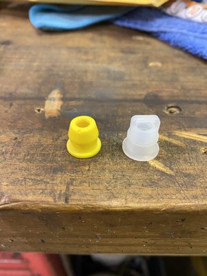

D Dewitt10jku 0 SUPPORTER Oct 26, 2020 #1 During the Dixie it happened again. I went to shift to 4 Lo and bushing broke. This is an know problem on jk’s. The only thing I found bushingfix.com. 3 times the price of bushing. Just wanted to know if anyone has any experience with them?

D Dewitt10jku 0 SUPPORTER Oct 27, 2020 #3 When I crawled under jeep to look. The bushing was gone. I had an spare and fixed it on trail. Just trying to find something that will last.

D Dewitt10jku 0 SUPPORTER Oct 28, 2020 #6 I order the bushing from bushingfix.com. Will see how it last.
D Dewitt10jku 0 SUPPORTER Nov 1, 2020 #7 Got the new bushing in from bushingfix .com. This bushing is a lot softer than factory ones. I don’t see it lasting longer but I’ll give an try
