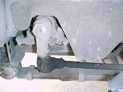

The stock steering arms on the front axle from the 79' Toyota arent correct because they are the original set up with one hole one each knuckle at the front and then the horshoe style knuckle on the back of the driver side with the arm that connected to the steering box. Once I cut everything out and mount the solid axle under there my IFS steering system will not bolt up from what Ive been told?

Man to do a sas swap in 2 days I would think you would have to be a mad scientist or something. Then you may have to rotate your steering box also. Usually if you put an ifs steering box on a 85- truck you mount the box so that the pitman arm barely misses the frame when you steer. Like I said may have to. What else you need to do is steering studs. Like arp or tg. You don't "have to" if they aren't in the budget but it's a very good upgrade and I almost promise you the stockers will fail you one day. Stay away from Tg tie rod ends. China junk, saw a few go out on my vaca out west that cost him hitting some really good trails. I've had them and the boots bust rather quick. And they rust. Get on car-parts.com and see if you can score some off an fj80. Oems are the best inmho.
