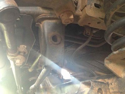

Gabes was on a gd Cherokee and the "frame" side mount failed. How is that relevant??
Still applies to my point. Overbuild the whole panhard system. They see a ton of force. That's all I am trying to point out. Yall can make your own choices, I have an IFS system to design for KOH.
And if you are talking about Scott with the Gand Cherokee his was 4 linked in the front with full hydro.
His was 4 linked with a panhard. The panhard bar was folded in half when they towed it to Tommy's shop, and the axle was kicked off to the side.

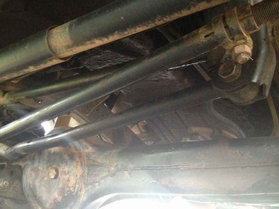

George, I never had any problems with the 1.5" .250 wall trac-bar with 3/4" heims on my Toyota.
this is what Im going to do, 1.5/.250 panhard and 2/.250 links with 7/8 heims, 14in coilovers
