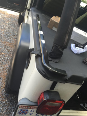

I wish the rear tubs matched the YJs. They are more rounded. I have been trying to decide if i should use my pieces i collected for a stretch or just cut the back of a tub and graft it in.
I have seen people graft LJ tub back to a YJ tub, the actual tub is the same. You just have to add a belt rail to the top of the tub to make it match a LJ or TJ.

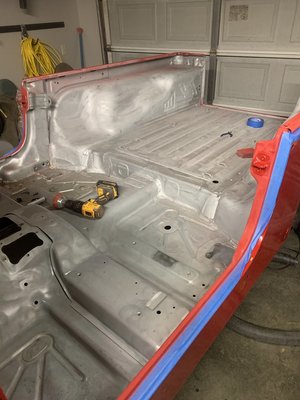

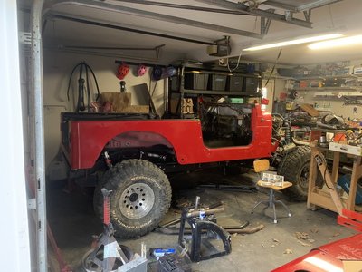

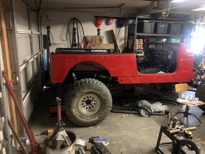

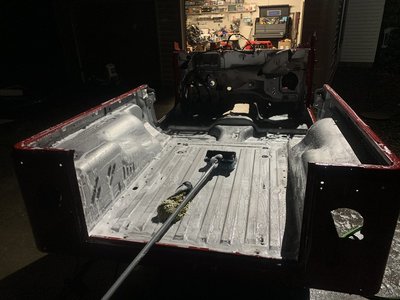

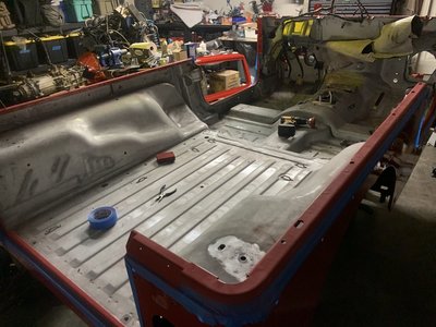

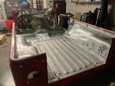

Spent the evening in the garage last night. David was able to almost finish the brake lines and I prepped the tub for raptor liner.
nothing like washing the inside of your jeep at 11pm

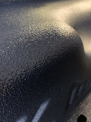

Cant wait to see how the raptor liner turns out. You'll have to let us know what pressure you spray at if you can try to get a close up shot to see the finish texture!
