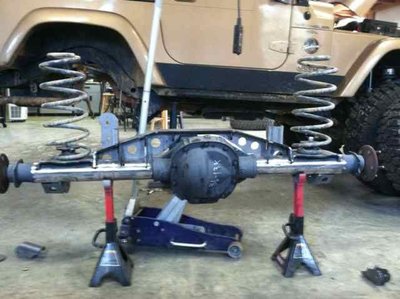

First time builder
Looks good Scott. Did the axle come with rotors, calipers, etc?

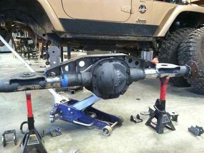

Yes, I should have all the parts now. The kit makes it pretty easy to line everything up, but what's the best way to get my pinion angle right. Do I need to mock everything up with the weight on it or is there a better way?
If you were happy with the pinion angle on your stock axle, level the spring pads and measure the angle on the stock axle and duplicate on the 8.8.
The stock axle needed to angle up more. I had a vibration and the transfer case is dropped about 1.5. I was hoping to put it back up where it belongs.
I think artec assumes you will have adjustable control arms. Their picture also makes it look like they have put a decent amount of pinion angle into the system. Adjustable arms is gonna be the only way to make the angle specific to your jeep and ride height.
The wording in the link for the kit refers back to "factory link, sway bar and shock locations" so it's probably gonna have a similar angle as your original axle(adjustable upper control arms would allow you to set the correct angle). Also, read the reviews, it looks like you may want to rotate the shock mounts a little to keep the shock tubes from hitting the axle tube at full droop.
Yes Larry I do have a SYE and cv driveshaft. Ad I do have adjustable upper and lower control arms. Artec suggested the angle should be between 12 and 17 degrees. My old axle was at about 12 degrees. I was going to put it at 15 and let the adjustable control arms dial it in from there. But I think I will wait to weld the shock mounts on last because they were hitting the spring pads before.
