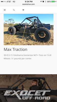

Exocet off-road. Side by side
88XJROX

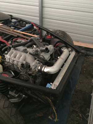

Finally sold the race car. Instead of finishing my project for the race track I'm preparing it for the trails. Side by side rear wheel drive
9" Kosei with 32x10.5-15 bfg's from the XJ
More to come
