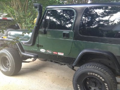

drive shaft?????
[/IMG]
the SYE and the tcase drop both try to do the same thing essentially, but with an SYE you can raise your skid plate back up to the frame and not run the drop brackets. If you want to fix it correctly you would need to do an SYE and CV driveshaft. Carolina Driveline has great customer service and can get you the SYE, then when you install it, you can call and they will next day your driveshaft to you so you minimize down time.
I am trying to stay away for cv drive shaft heard to many headaches with it. But I figure I will buy a sye quadratec has onf for 199 on sale and have the driveshaft for a 3to 5 inch lift. at not a to bad price. And then I will try to decide about diffrent lift methods. Although I think I have decided once my drive train is up to par to try out a three inch body lift on what I already have and 35s and stay at that. I want my play and reliability at the same time.
your going to pay $199 for an SYE plus $200+ for a Driveshaft that is generic for a YJ with 3-5" lift when you could get a better shaft that is specific to your jeep from a Reputable driveshaft shop located in SC that ships worldwide? um... ok good plan.
