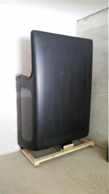

I've been putting off taking the hardtop back off the LJ because I didn't have a good way to store it. So, Tripp and I decided to break out the saws and build a cart. I looked at a few different designs online. We took some ideas from others and then winged it a little, and came up with this:

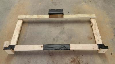

59" across the back, sides are 30". We stuck 2 pieces of 6" long 2x4 on the ends to keep it from sliding. The back spacer is about 5". The 1x4 across the front holds the window closed. We used tool box drawer liner for the padding, which works very well because it's non-slip, and it has some Harbor Freight cheapo casters.
How hard is it to turn it up and put it on the rack? Looks like a good idea
The cart has little stoppers on the bottom side, we placed the cart on the back of the top and just stood it straight up.... Shocked it actually worked as well as it did...

Thanks Matt. It's actually very stable, a lot more stable than we expected it to be. I'll try to remember to post it over there tonight.

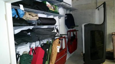

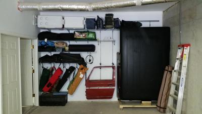

The idea behind the stand up cart was to be able to hang the doors on the wall and push the cart up around them. The hard doors and 2 piece soft doors fit nicely behind it.
