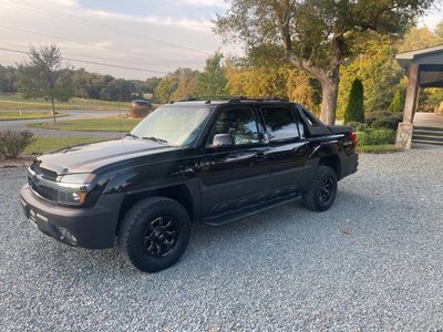

So I’ve been truck shopping and came across an Avalanche 2500 with the 8.1 big block. Does anyone have any experience with that motor. It has a lot of miles but the truck looks extremely cle

it has 200k+ on it but it’s really clean in the photos. He has it priced a little high at 9000. KBB is less than 6000. I’m thinking I’m going to pass. 562F1DE1-A2A0-4B63-A483-3E5E9DB92C00.jpeg
