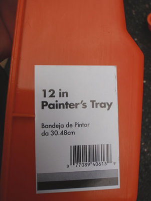

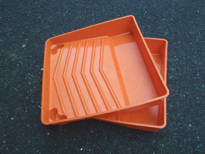

-Buy (2) 12" paint trays $4.99/each

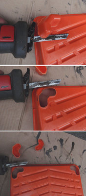

Step 1 - take the trays and cut off the support feet leaning forward

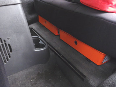

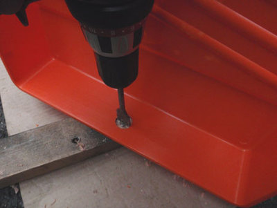

Step 2 - Carefully drill a hole so that you can stick your finger in there and pull the tray out from under the seat. I used a 1 inch wood bit, be careful when you get to the point where you are ready to punch out the entire circle, the bit can catch and rough cut the circle. (I used a one inch bit, pick one that works for you.)

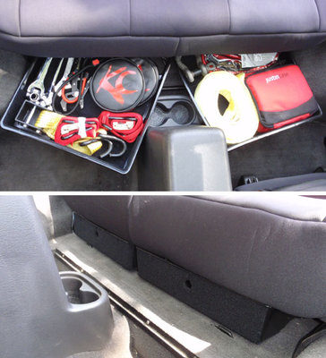

Step 4 - Take all of your great stuff and fill up your trays and test fit the trays with all of your stuff.

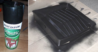

I was really trying to find black trays because I wanted them to blend in and be less visible but I was unsuccessful so I had to paint them. For those of you rocking orange Wranglers, you may want to leave it like this.

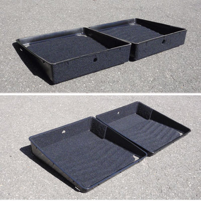

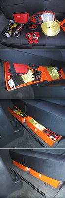

I wanted to keep the paint from potentially scratching off and also wanted to try to keep things from sliding around and making noise. I also wanted these trays to blend in a little more so I wrapped them in some extra black speaker box carpet.
Step 6 - (optional) Take speaker box carpet (color of your choice) and use some 3M Super 77 spray adhesive and line the inside of the trays. I also lined the bottom of the tray to keep it from sliding around under the seat.
