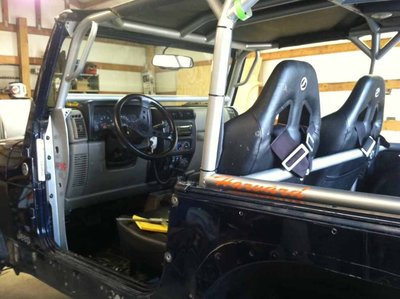

Me and Demarcus pulled off the armor today. Gonna take it this week for some paint.

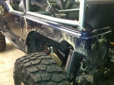

Thinking I may leave off the rear tube fenders. What do y'all think?
I like it without flares, but they may help with the mud slinging onto your back when you are going slow on wet trails.
Didn't help much the other day it didn't seem like. Lol. Still tryin to get all the mud out from the swamp run mason took me on
