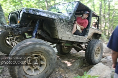

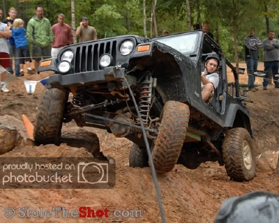

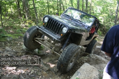

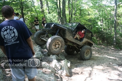

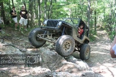

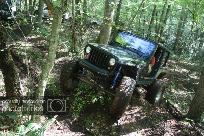

here are a couple i have from gulches and tellico of the pre-build
gulches
tellico
gulches

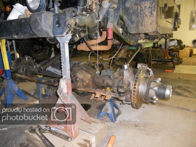

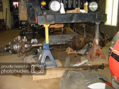

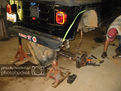

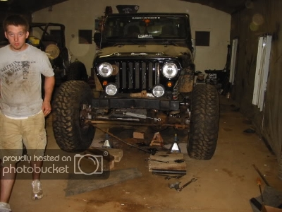

out with the old in with the new
some parts

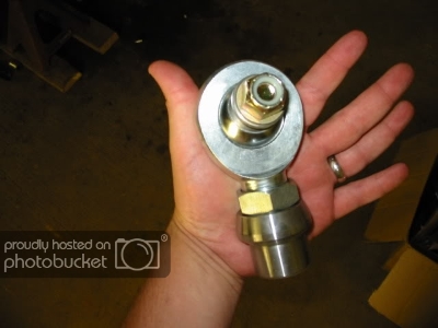

QA1s

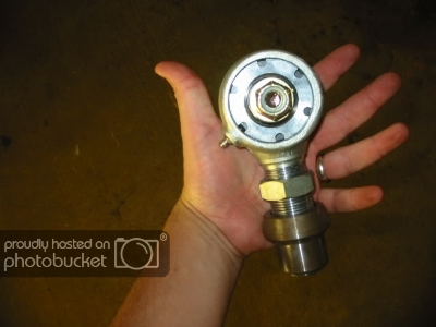

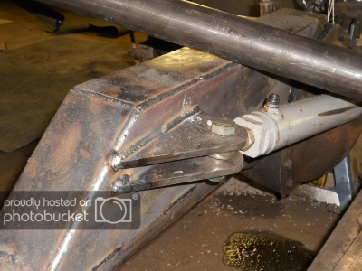

Ballistic Joints

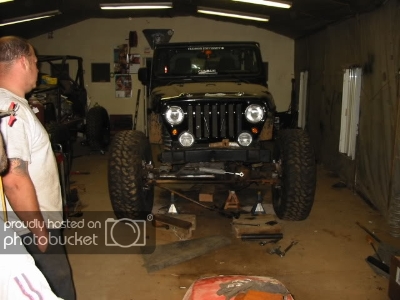

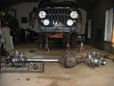

Front Mocked Up

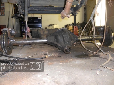

Rear Mocked Up/Tank Out

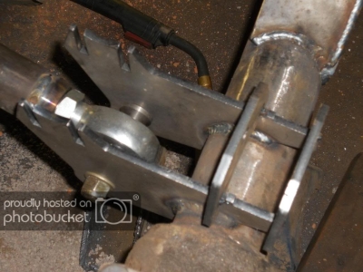

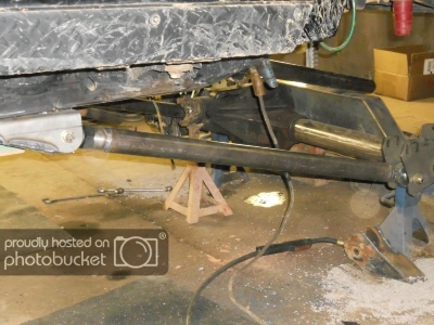

Lower Link

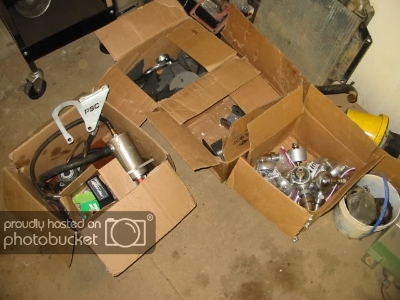

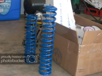

couple of pics of what brown santa brought.
we got the tank hooked back up and mounted in the cargo area of the jeep and all the links welded up. most of the brackets are tacked in after two days of modifing them because ballistic sent the brackets for the wrong size axle tube. more pics comin tommorow

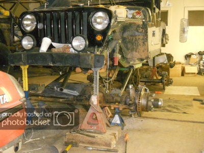

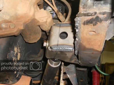

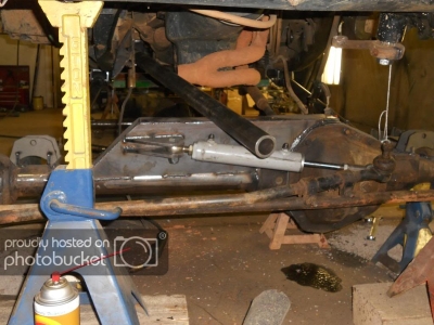

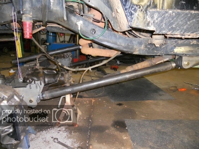

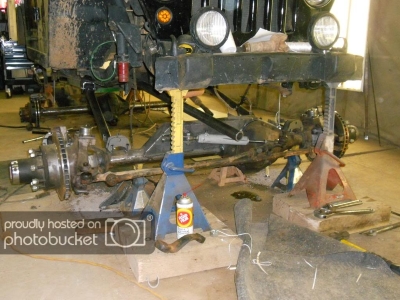

got the front lowers complete and tacked to the axle. we also got the front truss finished up.

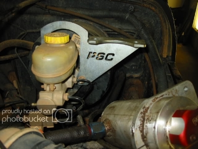

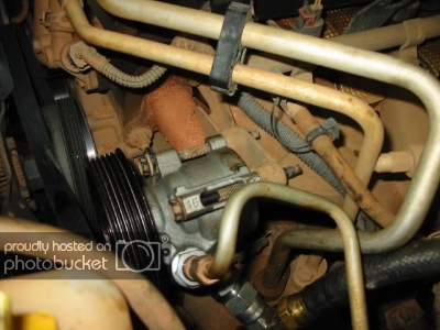

heres the new ps pump
and the resi bracket
should have the front uppers, rear uppers/lowers and rear truss finished tommorow

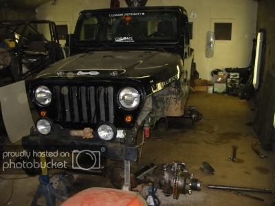

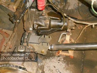

went to brads last night and got some more done. we tacked in the uppers, mounted the steering ram, set the rear axle in place, i found a flat pitman arm and installed that.

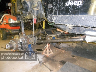

but here are some pics from last night.
front links and brackets are fully welded and bolted in. its about 1" over ride height.
tires are even with front of frame so it should have great approach. the coilovers will be here wednesday and steering heims from ruffstuff will be here friday.

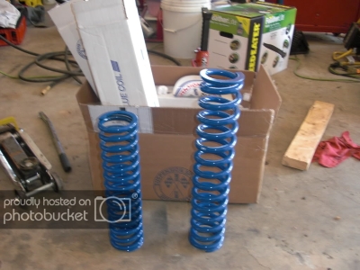

well its been a while since an update but we have the jeep sittin on its own weight with the front coilovers installed. all we lack is the front steering(which still hasnt shipped from ruff stuff after 11 days:mad3:) and to attach the fuel lines. more pics saturday hopefully of the finished product.:smokin:
bringing this back from the dead...as far as exhaust goes i could get you a pic but currently its cut off at the end of the "y" at the bottom of the motor. i havent gotten a chance to get the exhaust built. any muffler suggestions for the 4.0? also its back under the knife...were lowering it down a total of 2 inches by making the front coilover mount lower to the axle tube and cutting the rear spring perches down so that the retainer plate is sitting on the axle. in addition to the suspension modification a set of 40" ltbs will be on it in the near future as well as either a 14 bolt rear or 35 spline chromos for the rear 60. the front will be getting 35 spline outters. thats it for now ill post some pics of the progress once some is made.

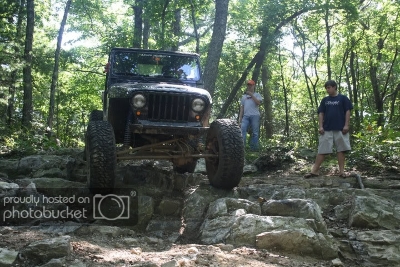

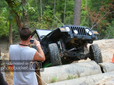

here are some pics while on the clemson off road club trip to bumpus cove and hurricane creek...
one of camp set up
eno should sponsor us lol.
that trip was basically its maiden voyage. drove it to each trail and back home a total of probably 8 hours on the road. i rode fine and did better than expected on the trail.
well guys sorry i havent updated lately...but i finished up the front lowering and i got the 40" ltbs mounted before our annual harlan trip. we left for harlan on saturday the 11th and got back yesterday. the only wheelin the group got in was on saturday afternoon. the two buggies in our group tried little jagger with no luck, that hill was slick!!! and we wasted the rest of the afternoon on lower rock garden fixing rigs...the first jeep trough lost a valve stem, the second rig through busted a hydro fitting, and then i entered and found that my ram was mounted at too much of an angle and kept rotating my tie-rod. once everyone was finally off the trail we headed back to the house for dinner. the snow started saturday night and was still comin down on tuesday when we left. i believe that when we left there was 6-8" at the house and 18-20" on the mountain. so the rest of the weekend was spent in the stadium doin doughnuts and climbin the hills surrounding it. ill have some pics up of the trip shortly. right now im trying to source a 14 bolt to build for the rear hopefully to have in before our next trip to windrock. check back for pics and updates
