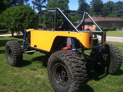

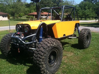

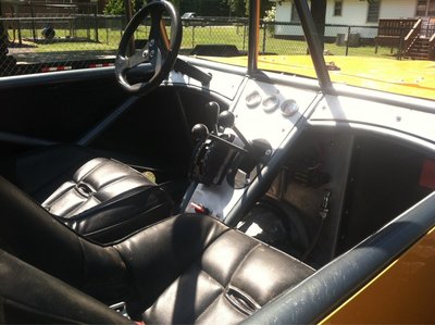

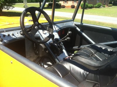

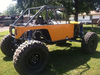

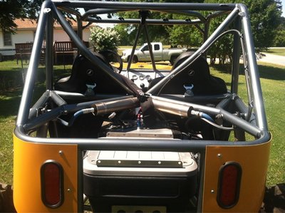

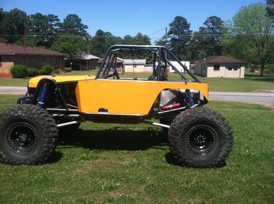

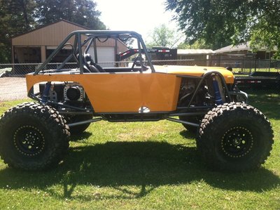

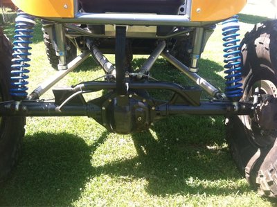

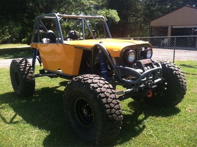

~108" wheelbase
~50" chassis (outside to outside) built by Essentially Off Road
39" Krawlers, on 17" Allied Beadlocks

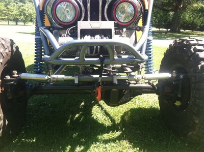

PSC double ended steering
Axles are full width, 35-spline chromo'd Dana 60s
HP front, 4.88 gears, Detroit Locker
LP rear, shaved, disks, Detroit Locker
Chevy 5.3 with LS1 intake, Advanced Adapters headers, baffled oil pan, 2.5" exhaust

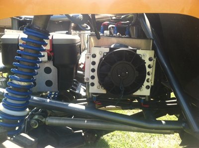

TH350, custom torque converter, Art Carr shifter, dedicated cooler with fan
3.8 Atlas II, 32 spine f/r, cable shifters
All new wiring harness
1350 driveshafts throughout, CV rear, 2-piece front
Narrowed CJ hood and grill
4-link front and rear, solid aluminum links and 1.25" heims everywhere
Bilstein 9100 coilovers, 14" front 17" rear
Bilstein air bumps all 4 corners
Build Pics:
http://www.fototime.com/inv/20B91F27F781F4F
Finish Pics:
http://www.fototime.com/inv/E52035F785C1D5E
As most of you have seen. I traded the #BlewTJ for the buggy this weekend. I think the buggy is a better fit for me that the full body rig although I did like the TJ.
Buggy is super clean. Fab work is top notch. Tons of over the top finishing touches.

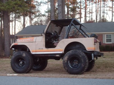

I absolutely cannot stand the color. And it may get some small changes made to the sheet metal because I am not a fan of how it's done either. I'll post some more pics Tuesday. I won't have much time until then unfortunately. My first thoughts were to change it to a FJ hood like Ram-Rod was but I think I'm digging the CJ hood. After all, the first rig I had was a CJ. I also plan to have the computer tuned to wake it up a bit.
