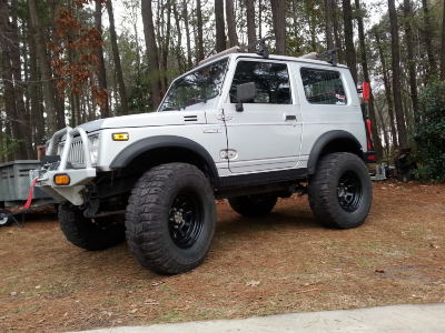

At her best:

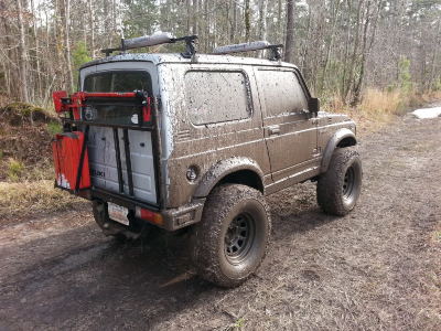

At her dirtiest.

Thats a clean rig. Whats under the hood?
It has the 1.6 Tracker engine conversion, so it's only marginally under-powered rather than grossly under-powered.
It came with a pile of parts to be installed. This weekend it's going under the knife for the 5.13/1 differentials, Spartan Locker, Front shock towers, rear shock mount and YJ spring conversion with missing links. While I'm in there, I'm going to do the front universals. I'm getting that tell tail vibration when the front hubs are locked. Should be a fun weekend.
