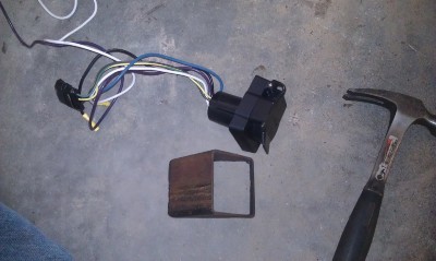

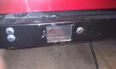

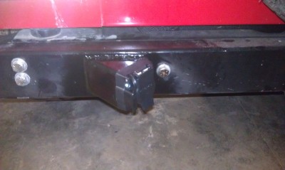

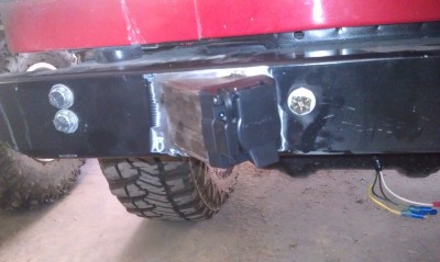

Since I got sooooo much feedback and suggestions here, I decided to try something different.
I cut some 3" square tube at 45 degrees and did a half recess of the plug. It turned out ok. I think if I did it over I would make it less of an angle to the bumper, but I think it's a good compromise for ease of mounting and protection from trail obstacles.

I just saw this thread, It looks good. Why did you go at an angle? just to help the cords line up?
It gave more room for the wire to be pushed towards the end of the bumper and let the whole thing not stick out as much. All of the connections are done with watertight connectors inside the bumper with only a 1/2 hole in the back of the bumper and crossmember.
