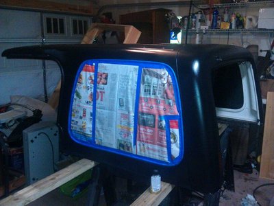

Tonight, I pulled it off the Hoist, and set her on some saw horses. Taped off the side windows, and removed the rear glass and artificial gutters. I then wiped it down with windex to remove the shop dust, and then sanded the entire top with 180 Grit paper, and wiped it down with Goo Gone. It made the top quite shinny :)

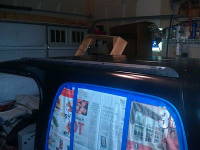

While waiting for the top to dry, I grabbed the set of Cherokee Roof Rails I grabbed at Pull a Part a few months back, took some measurements, and cut em down. I was unhappy with how high, and non adjustable the Thule system was, so I thought this would be a good alternative. This is about where they will sit on the top:

This Morning, the top was not shinny anymore. Instead it looked like most of the original TJ Black Flares.....Chalky colored. Beyond the point of return now :)
Yeah it was black, but it was faded and scuffed pretty bad. You could see white all over the top...actually, you still can :)
The GooGone made it shiny like that, but this morning, after it had dried and evaporated, it was chalky looking as I expected it would be. Good to know about the Clear Coat. I was thinking it would help protect it so I would have to paint it again any time soon. I'll look for some UV resistant paint for it instead....
