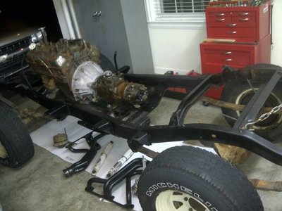

I found a set of narrow track axles in full working condition with fairly new brakes and springs for $100 yesterday. I have started doing minor body work on the hood, grill and windshield frame. All I need is a motor and this thing is ready to be put together. We decided we are going to fire this one and see what she does. We'll see.
This project is not dead. I am installing the other axles this weekend to return it to spring under. The frame, motor and tranny have all been cleaned and the motor is ready for rebuild. Just taking baby steps here. I'm walking here, I'm walking here! Here's a crappy pic. Well it wont let me post the dang pic

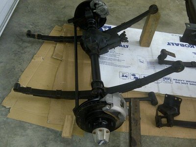

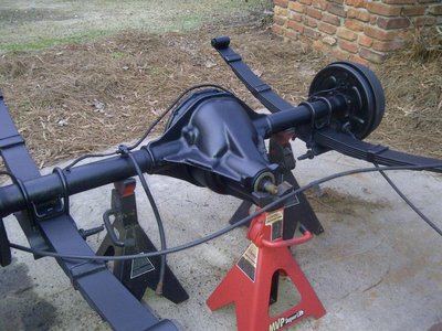

I went through the rear 20 and cleaned it inside and out. It seems to be in decent shape except for a couple small deals and the brakes are totally shot. The previous owner had painted the whole axle in rubberized undercoating or something like that. I had to chisel it all off. I didnt realize that there were 2 different brake size options for CJ's but this one has smaller drums, pads etc...then the spring over 20 that came with it when I picked it up.
Tonight I got it under the rear of the Jeep although I am going to order all new shackles tomorrow. I didnt want to have to replace anything that I didnt really need to but these are just trash. They are bent, pitted, siezed and the bushings are petrified. It sits so much lower now that it is spring under. I will probably just add a leaf down the road when I get the 33's that are planned for it. 33x12.50 BFG AT on White 10" wheels.

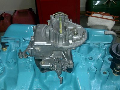

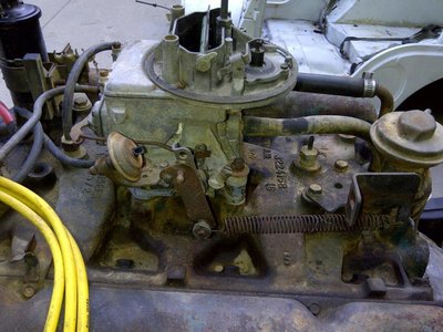

My dad rebuilt the Carb. Old:
Rebuilt:
I have not gone through the front 30 yet but my dad did throw some black paint on it because he cant have something that dirty and rusty in his garage. Looks like he even sand blasted the calipers knowing that they are siezed.

Next, what did you paint that rear axle with? Spray bomb? Looks really good in the pics.

Thanks Harvard. Its at my Folks house in their garage. My mom thanks me every day for it too! She says my Dad has something to do all the time now and isnt always a crab. I didnt see it working out like that! I work on it with him every Tuesday after work as the keep my little one on that day. I used paint scrapers on the axle to get all the undercoating off then hand sanded it for a couple hours. Thats flat black rustoleum but my dad insist on repainting it with Semi-Gloss black because he says thats how they came from the factory. Nothing on the frame or axles are finish painted yet. Just cleaned up a bit for now. I still have to weld a new crossmember in the rear and there is a scetchy spot up front. It's fishplated at the front. I guess it was hit although I feel like I have seen the same fishplate on other Jeeps. I'm gonna check it out.

Wire brush on a power drill and hand sanding. The wire brush was the ticket.
