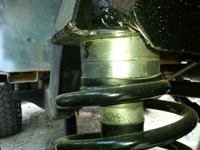

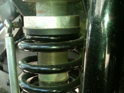

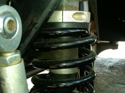

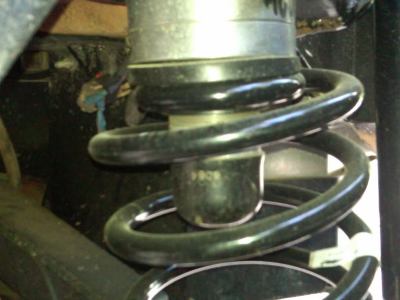

Here are mine on my drivers side front and rear. I took pics of the front and back of each spring as my front have a bit of the gangsta lean to them due to the front stretch and not either bending or relocating the front upper buckets yet.
Front
Rear
Thanks for the pics, mine are about the same when its just me and a passenger. I ran the numbers and when you add the weight of the new bedsides plus two teenage daughters and the tounge weight of the trailer....OME rates those springs for stock weight plus a constant 200lbs and I exceeded that on this trip by about 350lbs. Now that is why I have the Airlift bags, for times when the trailer is loaded and the kids are along for the ride. So I am leaning more towards Brook's suggestion that it may be more related to the suspension mods then the springs. It felt fine a Gulches when it was just the wife and I but, add the extra weight and the gremlins come out.
