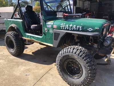

“Hatari” cj7
I may have missed it but what’s the specs on that steering linkage? I need to redo my Cj linkage.
1 1/4” dom with 5/8 heims, I would give you the lengths, but I’m running wide track axles, wouldn’t be the same for your narrow axle

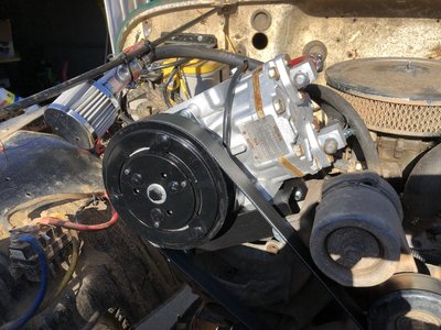

I was having a hard time trying to make the alternator charge, so I fabricated a adapter bracket and bolted a 10SI delco alternator up

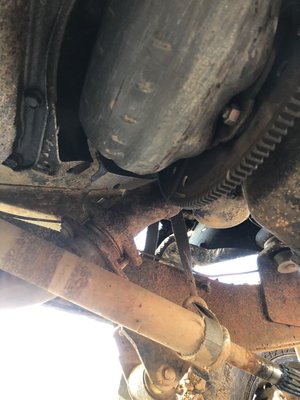

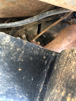

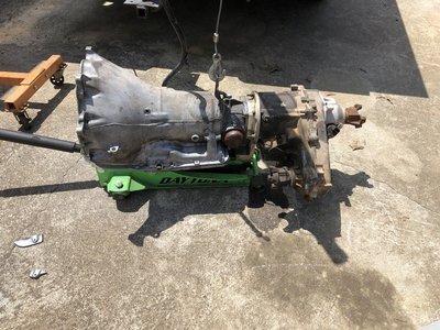

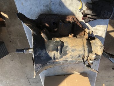

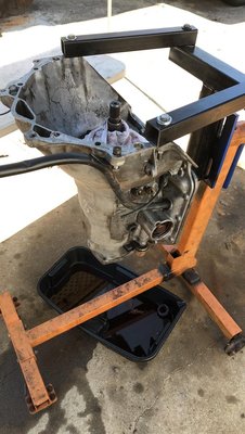

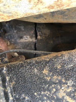

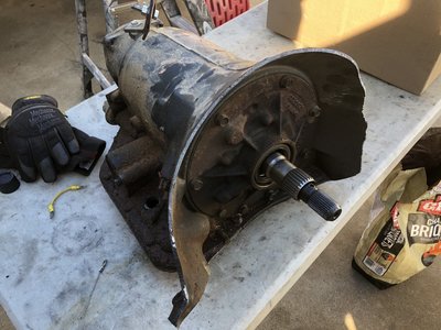

My trip to Gulches yesterday yielded some awesome carnage to my cj7, I have seen this happen before, but I have never had it happen to me. It broke the bell housing in half, I’m pretty sure the trans mount broke and caused it to brake. When it happened the trans hit the floor board followed by a very load pop.
