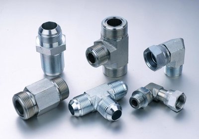

As far as the other fittings (45s, 90s, swivels, etc) They're only a few each.

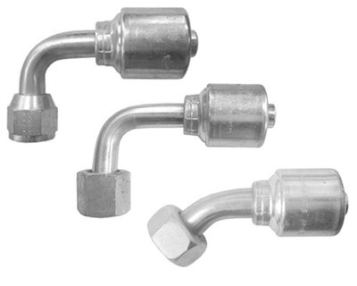

Brooks, which picture indicates the "low flow" fittings?
Thats if you get your hose from PSC, which, I'm sure 3000psi is plenty capable of holding the pressure of a power steering pump. You can easily build your own hose with the field serviceable fittings and make the hose rated to 4k psi as well.
I like the idea of the premade hoses so that I wouldn't have to fawk with making them, but I really dont see the downside to the do it yourself fittings?
My fittings came loose and blew off the line on the hose side twice. You can't really tighten them up on the trail with out pulling the line either, thats why I prefer premade lines.
