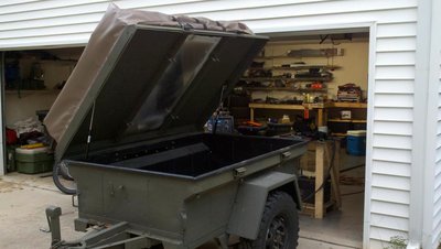

Bows and Hinge finally got here today. 45 min later, they are installed and I am ready to go...well minus the tent fabric that is being repaired by my mother in law (slave labor...gotta love it!hahaha)

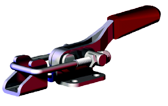

I need to make a few modifications to the trailer before she is ready to go...I love the ammo can latches, but I am having a hell of a time getting one to latch. I am not sure what the issue is, but it worked prior to the lift support installation. I am thinking of backing the side of the tub with a bit of steel to stiffen her up...if that does not work, I was looking at these....do you think they will work?
http://destacoclampstore.com/index.php?option=com_rokecwid&view=ecwid&Itemid=16#ecwid:category=688851&mode=product&product=4465629
I used destaco latches on my new lid. I had to brace the tub rail where the hinges are with 1x2x1/8" box steel so that even those latches would work properly. The trailer bowed to much without it, that is the issue you are having as welll.
Hmmm....Ok...I think I will just try to brace the inside of the tub with some 1x1 I have in the garage....

I'll try to get some pics of how I braced it, it helped tremendously.
Also, I was able to straighten the bed sides with my high-lift before I welded in the brace.
Fantastic....I may try that...I was thinking of just bolting in the brace since I have the interior bed lined, it seems like welding to that would be a bitch :)
