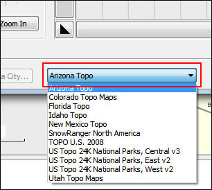

  6. Select the map you want to load at the bottom:
  7. Now highlight the segments you want to load (this can be the entire map) to the unit/card by dragging a selection box around the map displayed in the preview pane. Selected segments will turn pink.
  8. Now at the bottom select another map that you want to load to the GPS. Repeart step 7 for all the maps you want to load.
