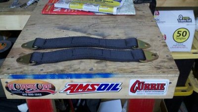

Limit Straps, where to get them and how to mount them.
Here are a few to get an idea

there will be a bumpstop in there after this coming weekend so that takes up the main space I planned to put the straps. I think i'm going to have to get the bump in first then see if it will work how I had planned for the straps.
Are you planning on mounting an axle end bracket to the axle tube or use the link or coilover bolt as an attatchment point?
well, the coilover bolt is mounted in the wrong directiong and the strap would hit the coilover, and the link bolt would put the strap going right through my tie rod haha.
