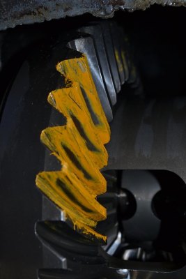

Anyone look at this and have any opinions?
ford 8.8, arb, 4.88s. The gear was under load when the pattern was taken.
It's pretty close. Nothing I would worry about. It does look like its not a well matched set of gears. You typically see a little more contact coverage, but it's not bad!
I may be smoking crack, but they don't look the same. The one closest to the camera looks centered but then as you go up the line they get deeper on each tooth.
Did you check the backlash? I've never seen a pattern with thin contact like that before, but I've never set up a ford axle before either.
I have no way of checking here at the house. I was sealing the cover because it was leaking and figured I would check the pattern
