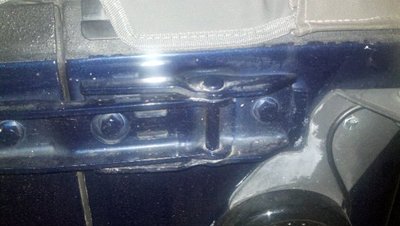

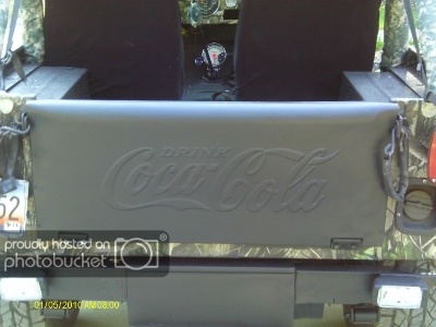

So I decided to take on this project as a quick something to do that would be under $50.00. My plan is to use 1/4"-20 Rivnuts, coupled with grade 8 hardware and a set of heavy duty Stanley hinges from Lowes. So Far I have picked up the Rivnuts, hardware and hinges for the project:
Gate Hinges: $5.98ea
Rivnuts: 25 for $12.35
Misc. Hardware: $11.00
I did some measuring last night. The Tailgate is 37.5" wide, so I decided to split that and put the hinges centered in the middle of each half. That ended up at 9 3/8 from each outer edge of the tailgate.

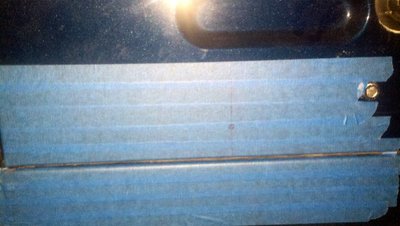

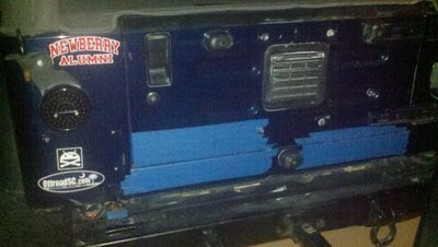

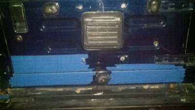

I covered the lower part of the tailgate and the cross member with painters tape and made some measurement marks. Thats as far as I made it last night.Here are some pics:

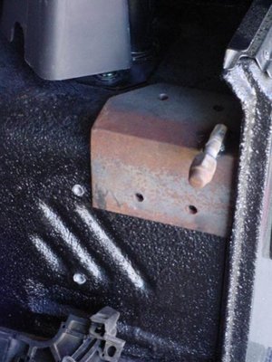

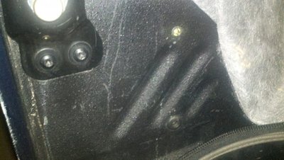

I plan on taking the upper hinge apart and putting a cotter pin setup in the existing pin hole that holds the halves together. The lower will just be the two halves so I don't have to repaint right now. I have not figured out how I will mount the support cables on the inside yet, but will probably use the existing holes for the insta-trunk and some more rivnuts, as I have a ton lying around from when I put the factory steps on.
Any comments or suggestions are welcome!
