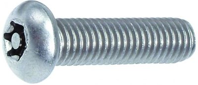

ok excuse my ignorance but what is a safety torx. I am just using a t45, but I saw it starting to strip and came inside to ask before I did something I couldn't undo haha. I already cut the rubber around the bottom like yu are talking about also.
the cage bolts in mine were safety torx, also called tamper proof torx. They have a peg in the middle, you need a torx with a hole in it for the peg to fit in.
Since you won't be reusing the torx bolts once the factory cage is pulled out, just weld hex nuts to the heads of the bolts and turn them out once they cool (the heat also help them break free). Another option is use a pair of vise grips or a small pipe wrench, but this method takes a quick minute and can be aggravating.
