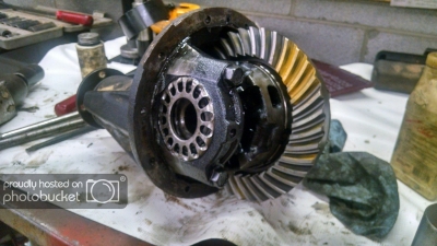

Finally getting around to installing the 5.29's. I've rebuilt my far share of toy front ends and this one takes the cake as far as being a mess. Both side axle seals have been gone for a very long time. I topped it off before going to Tellico and once I pulled the spindles fluid poured out of the knuckle.
Here's a list of things you need when servicing a toy front axle.
Brass hammer for the cone washers, a few good smacks on the hub body will free them up, make sure and keep your hand in front of them because they can rocket across the shop.
12mm socket for the hub bolts.
14mm socket for the spindle bolts.
17mm socket for the brake caliber.
A small flat chisel for the 54mm socket lock ring
54mm socket to get the hub body off the spindle.
Have the trans/transfer case in neutral so you can spin the axle shaft around to the flat sides on the birfield.

Whats it take to put hubs on an 80? You planning on doing so or keeping the slugs?
I have a set of hubs for it, I'm going to see if they will fit when I put the front back together. The big deal is this transfer case is full time. It's kinda like a limited slip, if you unlock one of the wheels in the front it will not move. That is until you push the CDL (center diff lock) switch. Then it locks the transfer case solid. Almost like having an elocker transfer case. Not all vehicles came with the CDL switch factory installed but the wiring is in the dash on all of them. I picked up the CDL switch from the dealership for $70.
To do it "right" you gotta grind a groove on the end of the stub shaft for a c clip, and install a part time kit, or weld one of the case spiders to the actual case. I found on mine that it was a much better driving vehicle with all wheel drive than it was in 2wd.
